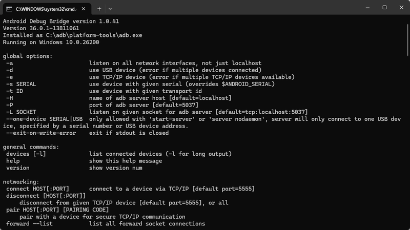

Open a terminal in the ADB folder and run adb. If ADB command help is displayed, the environment is ready.
ADB command line check
