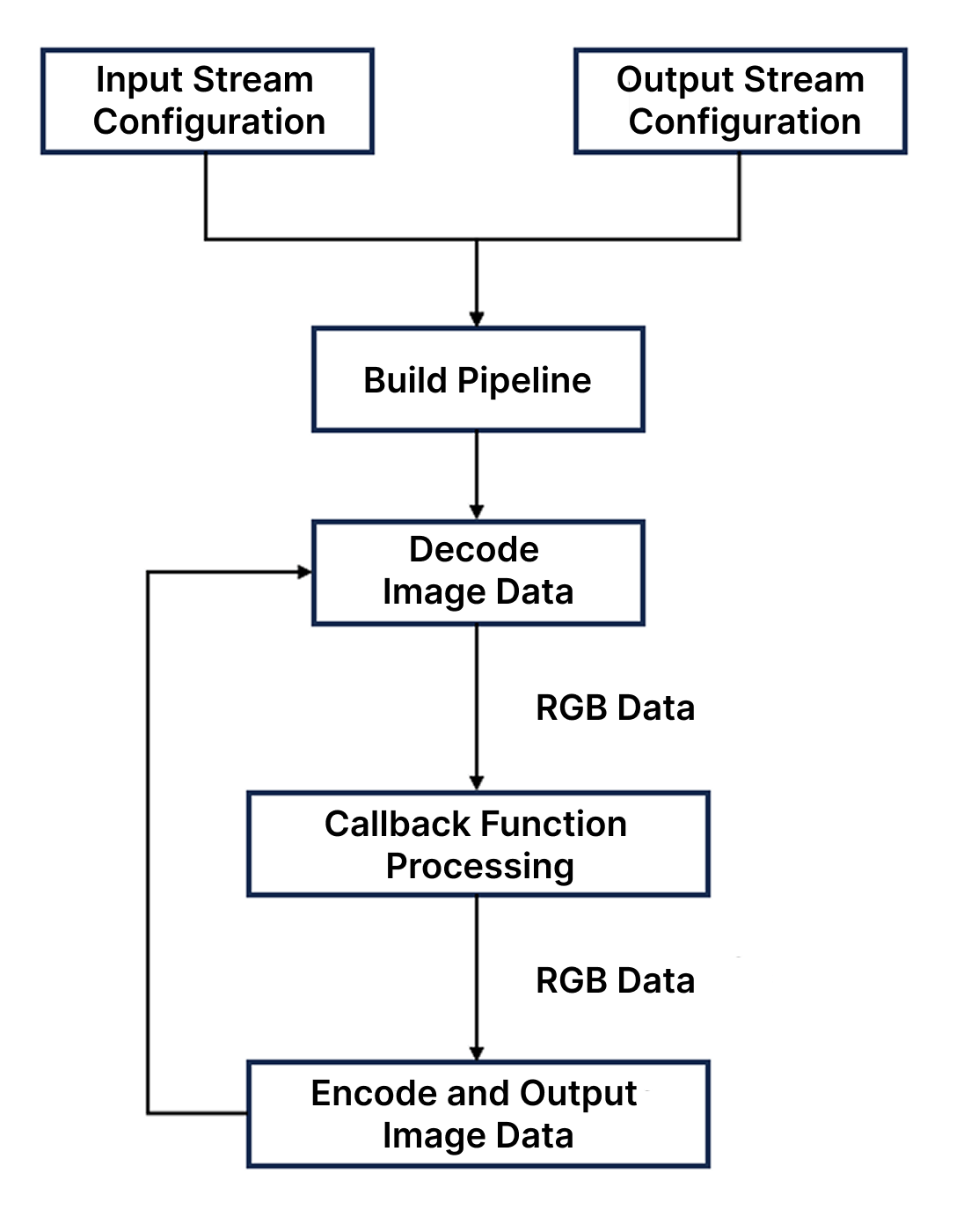

AidStream is based on the concept of pipelines. Developers can build predefined streaming data processing pipelines and combine custom processing tasks, such as AI model inference, with built-in tasks such as video encoding and decoding, stream pushing and pulling, and video stream storage to form a complete data processing chain.
In a complete pipeline, data enters from the Input Stream. Developers can use the AidStream API to obtain the corresponding RGB data and send the processed result to the Output Stream. For example, developers can insert custom callback functions between the input and output ends to obtain RGB data and other information. Data preprocessing, AI analysis, and post-processing can then be completed inside the callback before the data is returned to the pipeline for the remaining output stages.
The AidStream workflow is shown below:
AidStream workflow
